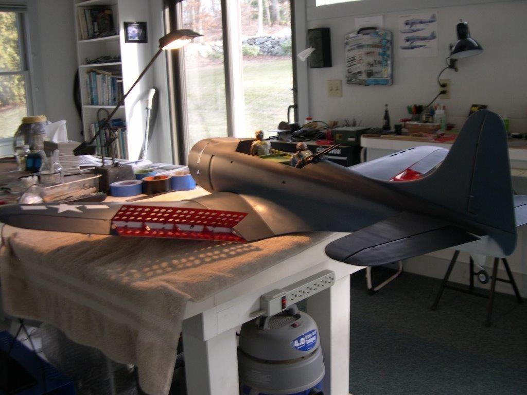

Glued in the balsa fillets then used bondo to round out the fillets.
Sanded down both sides of the tail one for a nice flow of lines.
Rear view. Looks straight anyway! 😆
Bottom view. For a smaller plane there’s a lot of wing.
This picture just says Dauntless!

Few goodies for the girl. Bomb drop and machine gun sounds with flashing leds in the nose gun mounts.
Going to start on the cockpit and canopies right after the fresh work at the stab and fin gets glassed up then primed.
Bottom view. Amazing sometimes how we think things are good, then we look and realize we didn’t shape things quite right. Took a fair amount of bulbous balsa of the tail cone and this is how it looks now.

Been doing some more work on the dauntless. Gerry did his magic on my gunner and pilot adding goggles and a life like face to this pair of vaily aviation pilots. Should look really good flying with open canopies.

Finished making the mailbox slots. They will get resin inside and finished up inside then get glued into the wing. Then they will get block sanded completely flush with the wing. Split some black soft tubing with a custom tool I made then we glued the tubing down with goop and some Zap. Very happy with the results.

Gerry got some painting done. Painted the white on the bottom of the fuse, bottom of the wing, and the small parts like wheels, retracts, flaps and ailerons. He painted the dark blue on the top of the wing, dive brakes, and aileron tops. Using the supplied decals for size and shape, I layed out Oracal blue stencil film on the wing and cut out just the star and bars on the top and just the blue outline on the bottom. Both will get sprayed their respective colors.
