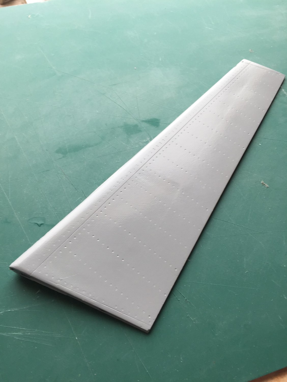

Pressing on, I built the tailplane using a traditional built up sheeted structure then glassed. The center bullet fairing was 3D printed.
Primed and then coated with a couple of coats of Duratec, again sanded down up to 1200grit, I engraved the surface details. Part way through I had a change of plan and cut out the tailplane flaps to mold separately.
The Buccaneer has an all-moving tailplane with tailplane flaps which I planned to replicate. The tailplane flaps are used when the wing flaps are deployed.
For the surface detail I used a scriber for the straight lines and a selection of hypodermic needle tubes in a Dremel for the rivets. To get the even spacing, I laser cut a set of rivet templates out of 1/16" ply.
I soon switched from the scriber to an set of small engraving tools to give a square cut groove. 0.6mm wide seems to give a reasonable panel line representation.

Next to mold were the tailplane flaps, being relatively small parts, another step in the learning process.
Old 10-16-2018, 05:13 PM
JSF-TC
JSF-TC's Avatar
Join Date: May 2002
Location: Fort Worth, TX
Posts: 1,304
Received 135 Likes on 79 Posts
I designed the tailplane flaps in CAD and laser cut them from ply, with balsa blocks for the hinge points.
Forgot to mention that I was now spraying the mold with 2-part car primer to produce pre-primed parts in an attempt to conserve the surface detail and not have them be lost in multiple layers of final priming. That worked well from the beginning.
I laid up the tailplane with a layer of 2oz and 4oz glass cloth with a carbon strip for the trailing edge, all vacuum bagged.
Bonding in the internal structure I used a thickened mixture of epoxy, applied using a small zip-lock bag with the corner cut off, much like a icing piping bag.
I was really happy how the final tailplane flaps turned out.
